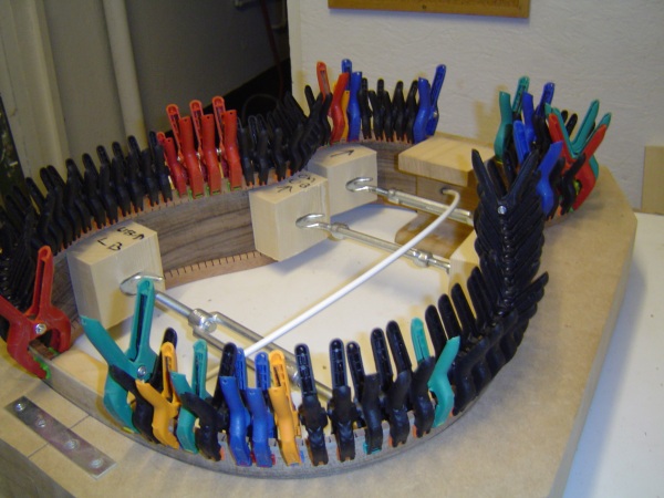

Funnily enough Sam, my favourite clamps for holding the kerfed linings on are 'Made in China', ?1.00 for 10 from Halfords, just the right width, articulated jaws and just the right strength!

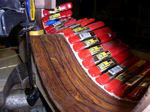

What type of clamps are you talking about?
This is what I use.

I suspect he is using these.
(I like them for all the pretyy colors. )

[QUOTE=Colin S] Funnily enough Sam, my favourite clamps for holding the kerfed linings on are 'Made in China', ?1.00 for 10 from Halfords, just the right width, articulated jaws and just the right strength!
Colin[/QUOTE]
Colin, I know the ones you mean. They are amazing. What is it, five for a pound or something? They are all hitting the Poundstretcher-type stores as if there's a new fashion or summat!!

Yes the ones like Steves are the ones I like they are the best clamps I have found for holding the linings on and as 10 for a ?1 (5 for $1), they are great value. I have never had a failure, but like any tool they should only be used for their purpose and to their safe limit.
The black ones with orange jaws are my favourites for size/strength ratio.

I use the wee plastic ones too. I think they are the bees knees for kerfed lining. Most other clamps have jaws too wide for the lining to properly conform to the shape of the sides ,particularly tight curves .
As Colin said, they are articulated , so fit either triangle or reverse kerfing . Mine have never let me down , nor have any blown up !
They have about the right strength for the job , but
I strap some rubber bands around a few to use on stubborn areas .
Colin , I never noticed that the black ones were stronger than the others . Your not pulling a kiwi's leg here are you ?

No Craig I'm not pulling your leg. The coloured ones are Wolfcraft ones (friends a rep gave me a boxfull) but the black ones are cheap Chinese ones at 10 for ?1 they have slightly stronger springs, but they all work fine. I love them.
